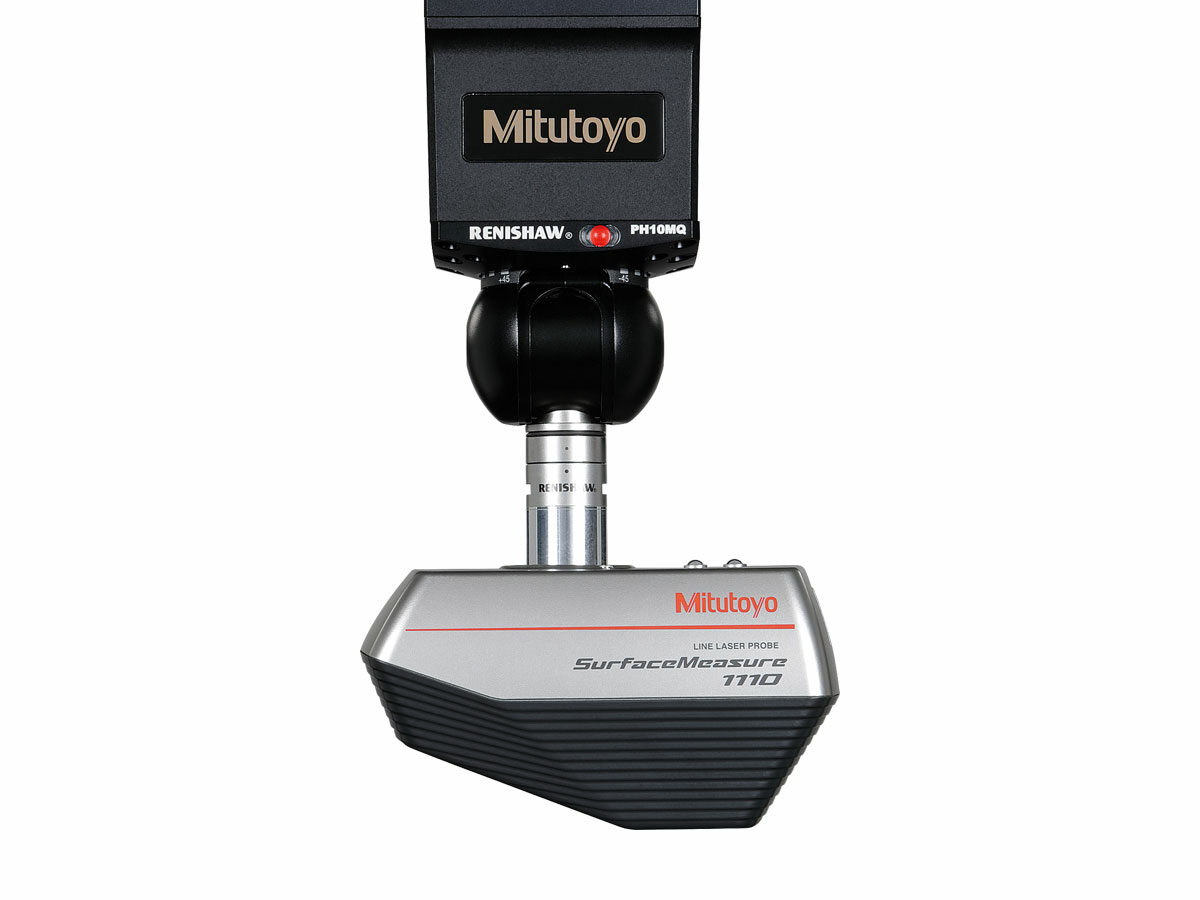

• Model 1110: The Mitutoyo SurfaceMeasure 1110 line laser probe, compatible with Mitutoyo CMMs, provides fast, high-precision, non-contact surface measurements. Ideal for automotive, aerospace, and medical applications, it efficiently measures complex geometries and freeform surfaces. In automotive, it inspects body panels and components; in aerospace, it measures turbine blades and airframe parts; and in medical, it ensures precision for implants and surgical tools. The probe enhances productivity while delivering reliable, accurate measurement data.

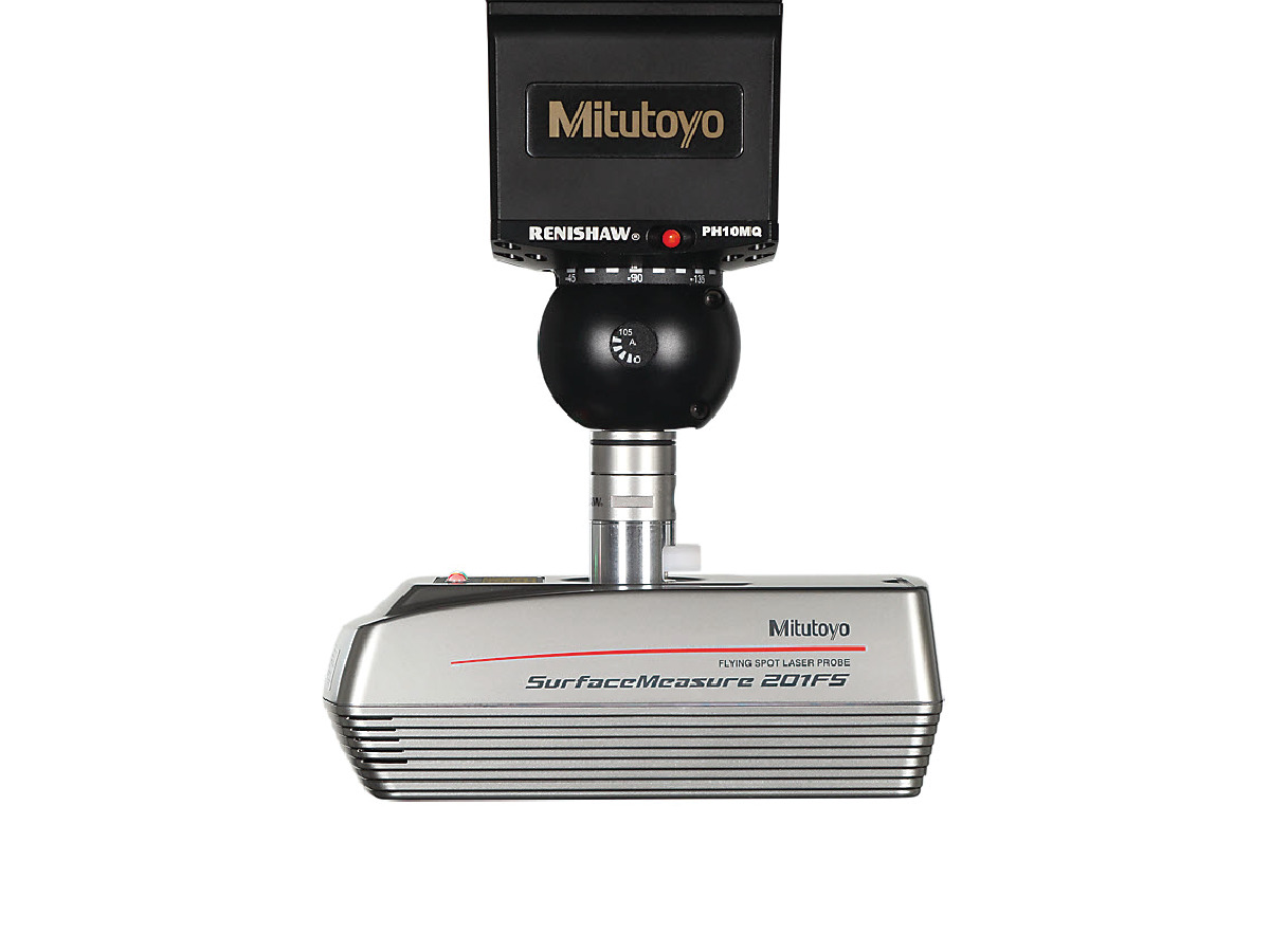

• Model 201FS: The Mitutoyo SurfaceMeasure 201FS is a laser probe designed for high-accuracy, non-contact form measurement using a point scanning method. The laser beam is focused on a single measurement point along the scan line, minimizing the impact of multiple reflections and ensuring precise results. This system is ideal for applications such as inspection, reverse engineering, and 3D data acquisition across a range of industries, including automotive, aerospace, and medical sectors. Its versatility and precision make it especially suited for capturing detailed surface profiles in complex geometries, offering reliable performance for quality control and advanced design processes.

| 02AQH010 | 1110 | PH10M, PH10MQ, PH6M | Autojoint Connector | CNC | MCOSMOS+MSURF | Laser | Line Laser | 4.33" 110mm |
3.933" 100mm |
10.53" 267.5mm |
300,000/s |
| 02AQJ900 | 201FS | PH10M, PH10MQ, PH6M | Autojoint Connector | CNC | MCOSMOS+MSURF | Laser | Point Laser | 0.90" 23mm |
0.59" 15mm |
5.80" 147.5mm |
25,000/s |
