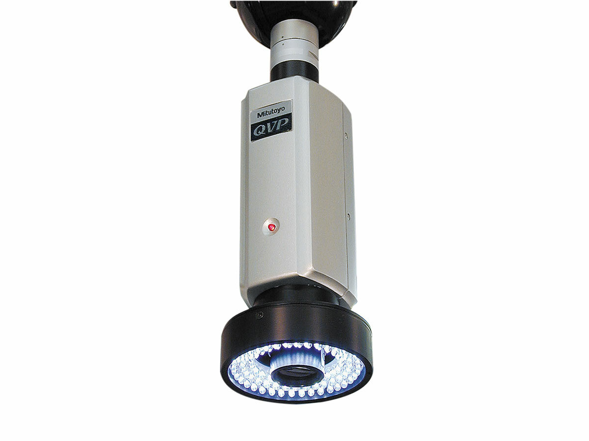

Non-Contact Probe Systems (Optical)
Optical probes are non-contact sensors that utilizes a camera optics to do automatic focusing and edge detection tools to gather points used to generate geometry for measurement evaluation.
The Quick Vision Probe for Coordinate Measuring Machines is a vision probe developed on Mitutoyo state-of-the-art vision measurement technology to enable full automation of image measurement with a CNC CMM. The QVP probe performs form measurement by image processing micro geometry that cannot be measured by a contact probe. This optical, non-contact measurement method is ideal for measuring flexible bodies that are easily deformed by slight measuring forces of conventional touch probes.
  • The QVP probe automatically detects workpiece edges using dedicated VISIONPAK software
  • Various calculations process, ie: dimensions and geometrical deviations are performed by general purpose GEOPAK software
  • Standard adjustable co-axial light in the lens system and white light LED ring illumination eliminates the need for auxiliary illumination
  • The QVO can mount on an automatic probe changer for fully automated measurement
Order No.: Optical
Probe:
Probe
Head:
Probe
Mount:
CMM
Type:
Software
Required:
Sensing
Technology:
Optical Tube
Magnification:
Co-axial
Illumination:
Ring
Illumination:
Objective
Magnification:
Observation
Range:
Working
Distance:
Depth of
Focus:
359-051-6A QVP PH10M, PH10MQ, PH6M Autojoint Connector CNC MCOSMOS+Visionpak 1/2" CCD (B/W) 0.5X White Light LED White Light LED Standard: 3X
Optional: 1X, 5X, 10X
Standard: 3.2x4.3mm
Optional: 9.6x12.8, 1.9x2.6, 1x1.3mm
Standard: 72.3mm
Optional: 59, 59.5, 44 mm
Standard: 56mm
Optional:306, 23, 8 mm
