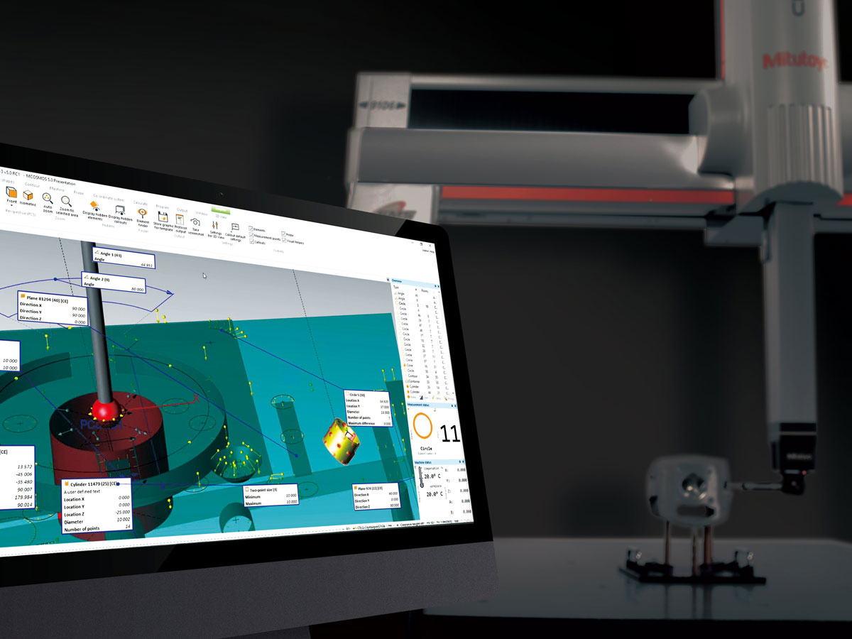

Find out how Mitutoyo’s CMM software can optimize the utility of our high-performance coordinate measuring machines. Whether it’s for CMM programming or measurement analysis, Mitutoyo CMM software helps make measurements and programming a CMM easier and faster.
CMM Programming
Software modules streamline Mitutoyo CMMs with intuitive interfaces enabling fast, efficient measurements and part modeling.
Mitutoyo offers several software suites with a variety of features that power different Coordinate Measuring Machine applications. The software suites, when paired with the proper CMM probe, support surface measurements, vision measurements, point cloud data processing, and fully automatic measurement program generator from CAD models on CMMs.
