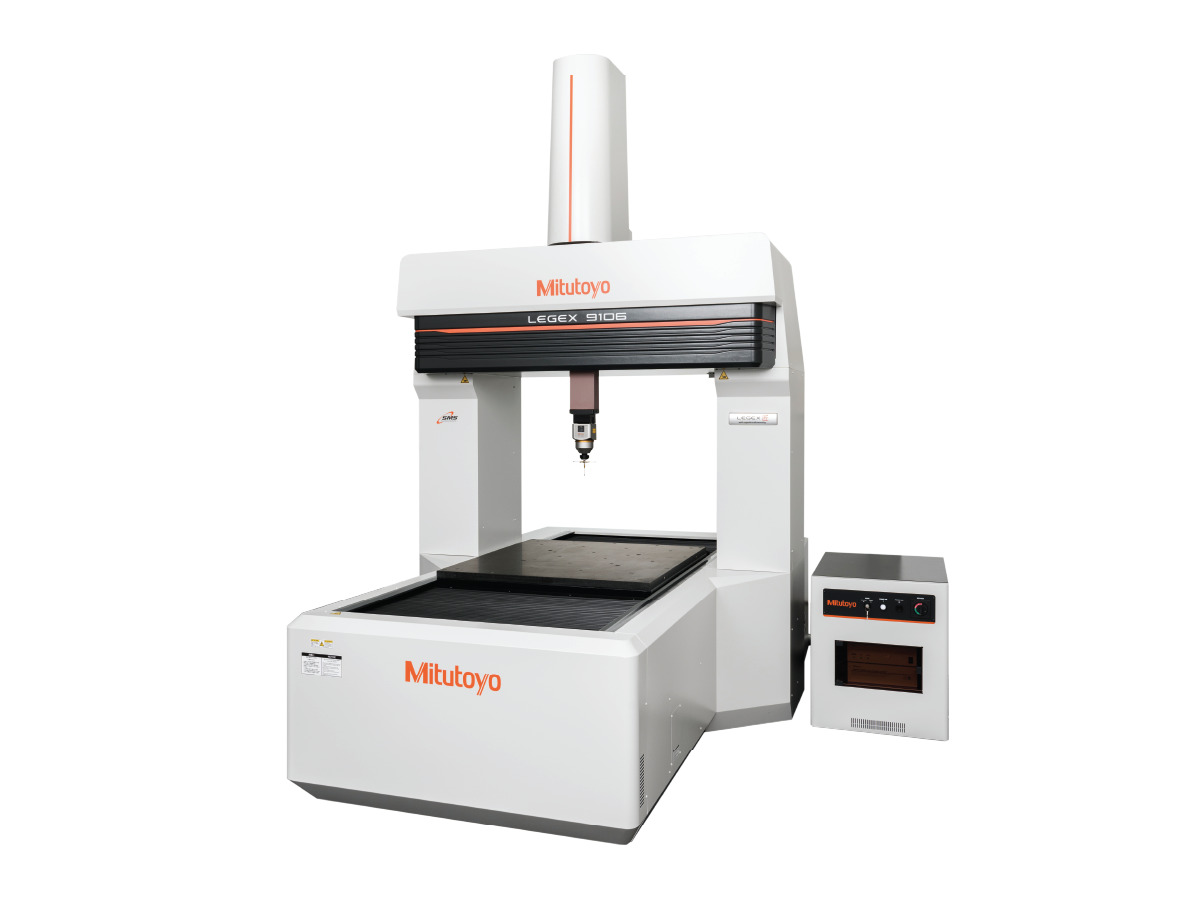

LEGEX TAKUMI
The Mitutoyo LEGEX TAKUMI Series ultra-high accuracy fixed-bridge CNC CMM is the ultimate in the world’s high-accuracy measurement technology. LEGEX TAKUMI series CMMs are suitable for complex small-to medium-sized workpieces that require dimensional accuracies with small tolerances like gears, bearings, lenses and precision dies.
The Mitutoyo LEGEX TAKUMI series CMMs incorporates an ultra-high accuracy scale unit with crystallized glass scales (thermal expansion coefficient of 0.01×10-6/K) and a high-resolution, high-performance reflection linear encoder providing premium positioning performance. The fixed-bridge design allows the X- and Y-axis to operate independently of each other while eliminating pitch and yaw errors. The LEGEX TAKUMI’s “center of gravity” drive system allows for very high speed while taking ultra-accurate measurements.
  • Air-damped spring isolators with an auto-leveling function eliminates factory floor vibrations from the machine
  • Rigid, durable construction with fixed-bridge design eliminates measurement fluctuations due to axis movement
  • FEM structure analysis simulation, guarantees geometric motion accuracy has minimal errors from fluctuations in the load and other variables
Technology: Coordinate Measuring Machine - CNC
Units: Inch, Metric
Resolution: 0.0000004"
(0.00001mm)
Guide Method: Air bearing on each axis
Vibration Stand: Standard
Probe System: PH10MQ
Touch Trigger Probe: TP7
Scanning Probe: MPP, SP25
Laser Probe: SurfaceMeasure
Optical
Probe:
QVP
Surface Roughness Probe: SurfTest
