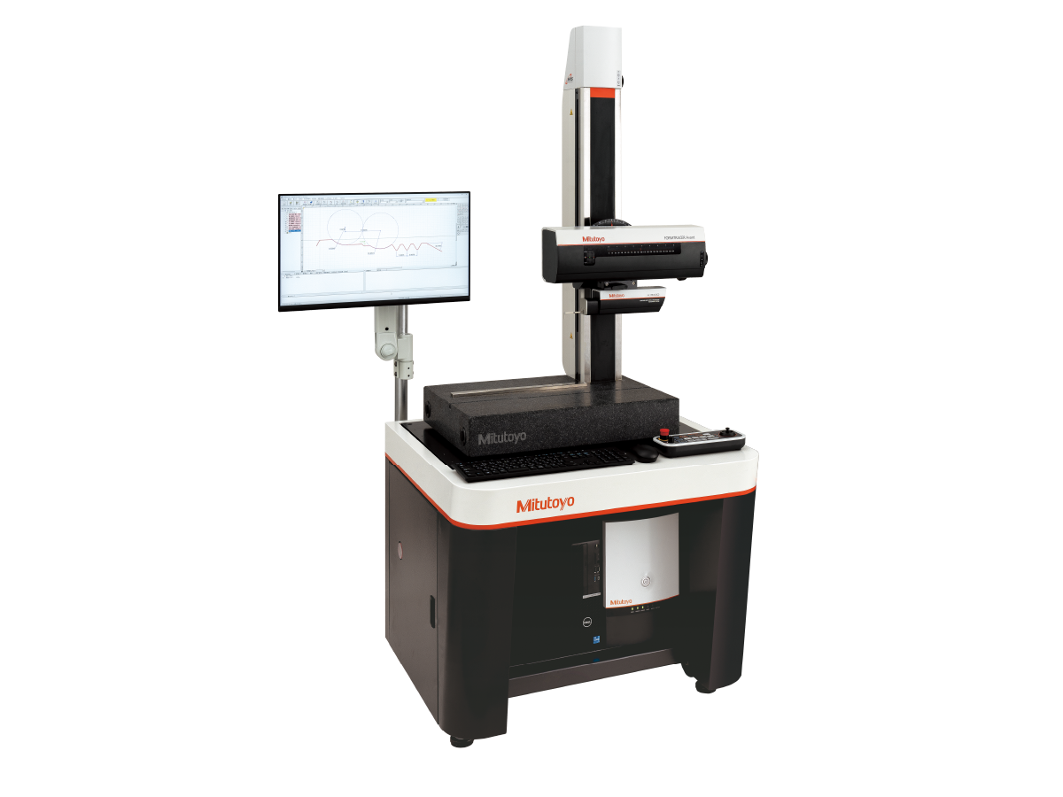

A versatile hybrid dual detector system with a single-sided stylus that makes contour and surface roughness measurements quickly and efficiently. The detector heads are easily swapped to change measurement types.
When it comes to detail and functionality, the FORMTRACER Avant H-3000 innovates form measurement with easier operability, greater accuracy, and more powerful, time-saving functions and features.
- Hybrid Precision, Zero Downtime – The H-3000 Detector allows for contour and surface roughness measurements in one trace , and can be swapped out without powering down the system.
- Complete Data with One Measurement Trace – The detector has both a wide measurement range and high resolution, allowing contour and surface roughness to be evaluated efficiently and with high accuracy in a single measurement.
- Unprecedented Accuracy – A newly developed arc scale helps the FTA H-3000 obtain even better precision and accuracy. For lens measurements, the detector achieves high-accuracy and high-resolution shape measurement, allowing accurate and precise evaluation of PV values.
- Remarkably Improved Workability – The drive unit inclines up to 45 degrees easily measure inclined surfaces without using a jig.
- Improved Stylus Speed – The retraction speed of the stylus is approximately 2x to 3x faster than conventional models, while the stylus speed for contact has been slowed in consideration of measurement safety.
- Improved Design – The system incorporates a cable-less design, allowing part set-up without concern for obstructions and snagging on unprotected detector cables.
- Beyond Normal Measurements – The best-in-class 2-axis measurement range can be increased using optional extra-length styli.
