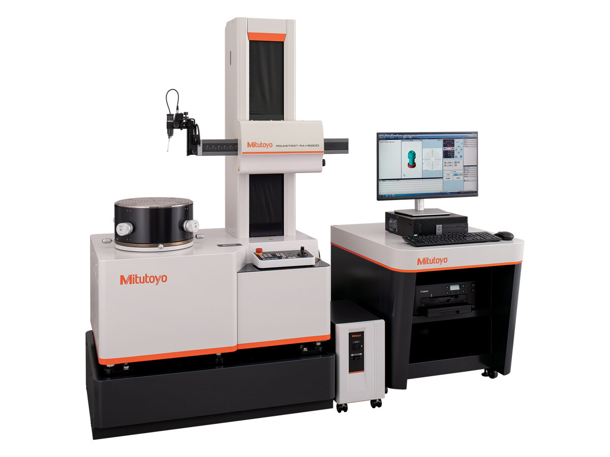

The Roundtest RA-H5200 roundness/cylindricity measuring system combines world-class accuracy with superior maneuverability and analytical capabilities for large-size and heavy workpieces.
The Roundtest RA-H5200 roundness/cylindricity measuring system features a rigid base and highly accurate, highly rigid turntable that achieves exceptional manufacturing accuracy of  critical components, such as the rotor and stator, in addition to an air-bearing which incorporates a complex aperture that provides superior rigidity and uniform pressure distribution. As a result, the rotational accuracy (radial), which is the heart of the roundness/ cylindricity measuring system, is a world-class (0.02 +3.5H/10000)µm. A high-accuracy Z-axis column achieves ultra-high column straightness, combined with high-accuracy positioning sensors in the X- and Z-axis drive units provides highly precise and repeatable measurement capabilities. Measurement while tracing is possible through a built-in linear scale in the X-axis to maintain contact with the workpiece surface when displacement due to form variation exceeds the measuring range of the sensor.
  • Automatic Adjustment Table (A.A.T) provides high-speed centering and leveling automatically, greatly reducing total measurement time
  • Spiral-mode measurement function combines table rotation and rectilinear action allows cylindricity and coaxially for other data to be loaded as a continuous data set
  • Continuous OD/ID measurement function performs internal and external diameter measurements without the need to change the detector position
  • Enhanced detector safety functions, such as accidental touch and collision detection, minimizes damage to both machine and workpieces
  • A surface roughness detector, compliant with the relevant International Standards, can be mounted in place of the roundness measuring detector to create a multiple sensor testing system for roundness/cylindricity and surface roughness
Bearing Type: Air
Table Adjustment Method: Automatic mic heads
Rotating Speed: 10, 2, 4, 6rpm
Table Diameter: 11.8" / 300mm
Table Centering Range (With DAT function): ± .2" / ± 5mm
Table Leveling Range: ±1°
Max Table Loading: 176lbs / 80kg
Table Max Probing Diameter: 15.7" / 400mm
Table Max Loading Diameter: 26.8" / 680mm
Column Traverse Method: Motorized
Column Measuring Speed: .5, 1, 2mm/s
Column Max Probing Depth: (Over ø1.26) 3.34" / (Over ø0.27) 1.97" / (Over ø32) 85mm / (Over ø7) 50mm
Radial Traverse Method: Motorized
Radial Traverse Range: 8.9" / 225mm
Radial Drive Speed (Max): 50mm/s
Radial measuring speed: .5, 1, 2mm/s
Detector Measuring Force: 10 to 50 mN
Detector Stylus Tip: Carbide ball diameter .06" / Carbide ball diameter 1.6mm
Standard Detector measuring range: ±4, ±40, ±400μm
Follow Detector measuring range: ±5mm
Detector Measuring Direction: Bi-directional
Stylus Angle Adjustment: ±45°
Data Sampling Points: 14,400/rev
Filter Type: 2CR50, 2CR75, 2CRPC50, 2CRPC75, Gaussian, Off
Cut-off value: 15, 15-150, 15-1500, 15-500, 150, 150-1500, 1500, 50, 50-1500, 50-500, 500, manual setting upr
Reference Circle for Evaluation: LSC, MCC, MIC, MZC
Air pressure: .39 Mpa
Vibration Isolator Mass: 375lbs / 170kg
Order No.: Product Image: Column Traverse Range: Column Max Probing Height: Main Unit Dimensions: Main Unit Mass:
211-531-11 - 13.8" / 350mm 13.8" / 350mm 49.6 x 28.0 x 66.9"/ 1260 x 710 x 1700mm 1433lbs / 650kg
211-532-11 - 21.7" / 550mm 21.7" / 550mm 49.6 x 28.0 x 74.8"/ 1260 x 710 x 1900mm 1477lbs / 670kg
