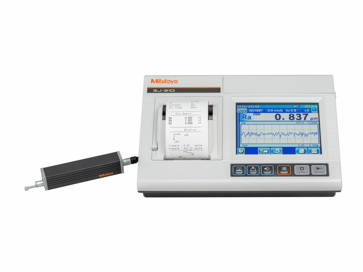

The Surftest SJ-310 surface roughness measuring instrument is a compact, portable and easy-to-use surface roughness measurement instrument equipped with extensive measurement and analysis features.
The Surftest SJ-310 surface roughness measuring instrument provides accurate results in a compact, portable unit. The detector supports a variety of measurement orientations and can make measurements vertically and upside-down. The Surftest SJ-310 includes as built-in thermal printer which provides operators the ability to instantly print measurement results on site.
  • Built-in 5.7-inch color graphic, back-lit LCD touch-panel display provides superior readability, ease-of-use and visibility in dark environments
  • User interface provides intuitive, easy-to-understand operability
  • Reinforced Measure-Start, and other frequently used buttons, resist wear and workshop contaminants
  • Large-capacity battery allows approximately 1500 measurements when fully charged
  • Built-in high speed printer prints in landscape or portfolio mode for different applications
  • Internal memory stores up to 10 measurement conditions and one measured profile
  • An optional memory card can be used to store large quantities of measured profiles and conditions

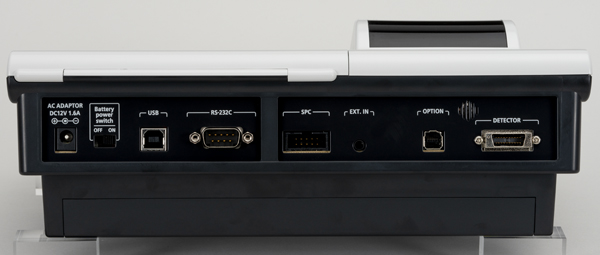

External I/O: Digimatic output, Footswitch I/F, Printer output, RS-232C I/F, USB I/F

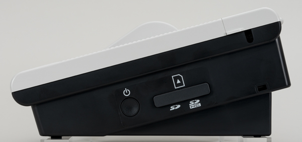

External Data Storage: Micro SD card
