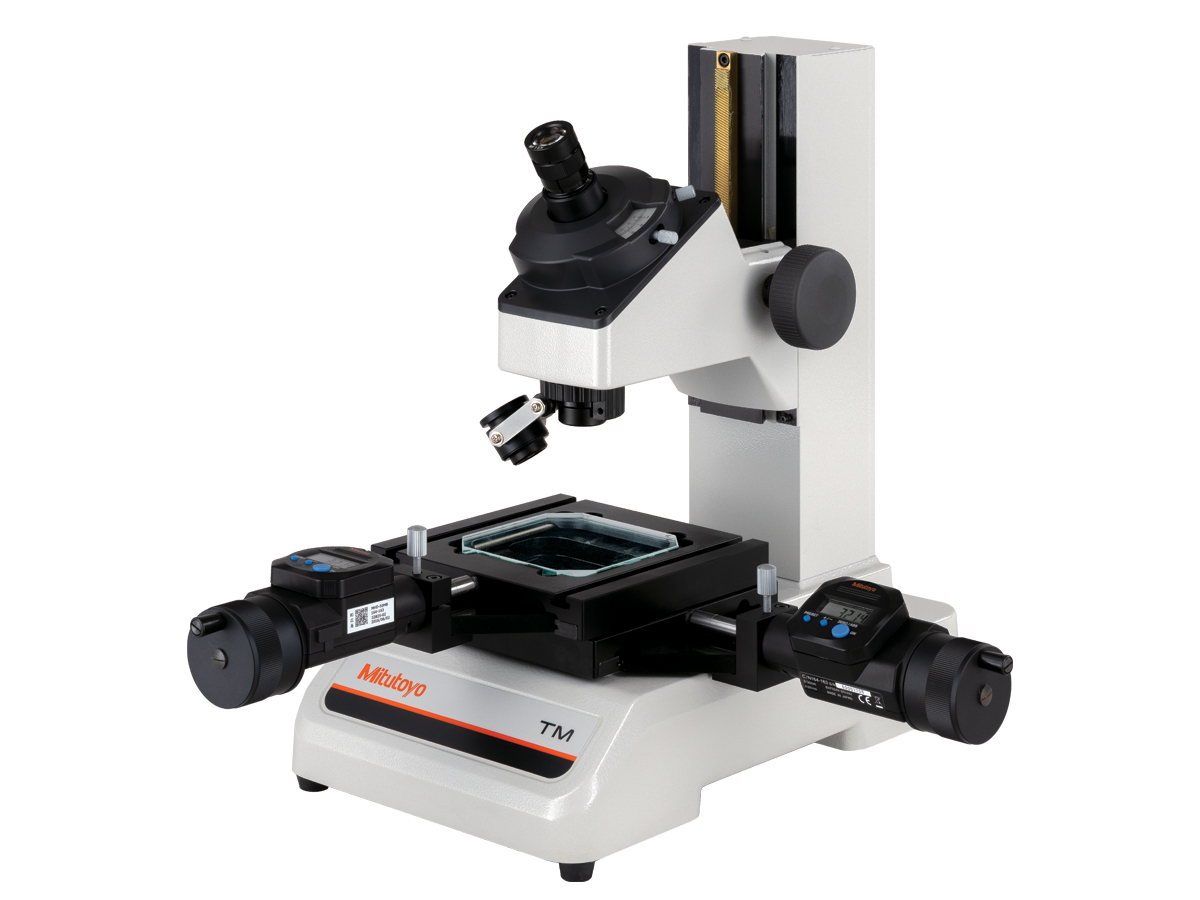

The Toolmaker’s Microscope Series 176 provides a bright, clear field of view through LED illumination, delivering superior performance within the small-model class. Quick and easy measurements can be conducted using digital micrometer heads, which can be mounted directly onto the microscope stage.
The Mitutoyo TM Series is a microscope well suited for measuring dimensions and angles of machined metals. This series of microscopes has a newly designed LED illuminator with stepless intensity control for enhanced observation. The compact body makes it ideal for use on shop floors with limited space.

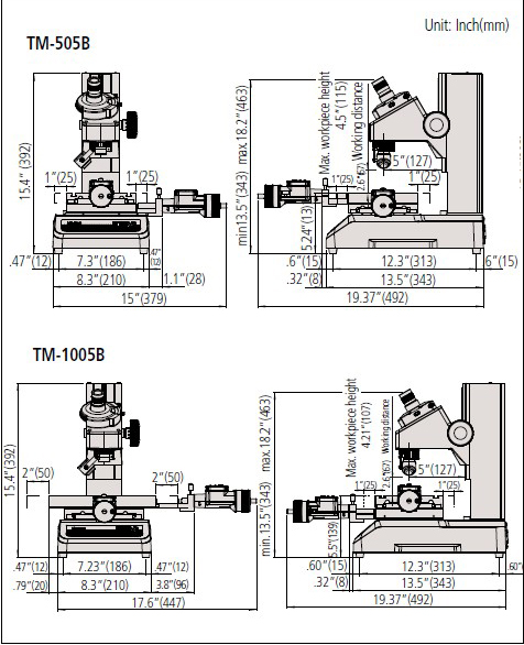

| Order No.: | Product Image: | Model: | Microscope Head Maximum Height of Work Piece: | Stage Measuring Range: | Table Size: | Usable area of stage glass: | Linear Measurement Method: | Resolution: | Mic head travel: | Accessories: |
| 176-818-11A | - | TM-505B | 4.53" / 115mm | 2 x 2" / 50 x 50mm | 6 x 6 / 152 x 152 | 3.78 x 3.78" / 96 x 96mm | Micrometer Heads Optional | - | - | - |
| 176-819-11A | - | TM-1005B | 4.21" / 107mm | 4 x 2" / 100 x 50mm | 9.44 x 6 / 240 x 152 | 6.06 x 3.78" / 154 x 96mm | Micrometer Heads Optional | - | - | - |
| 176-820-11A | - | TM-A505B | 4.53" / 115mm | 2 x 2" / 50 x 50mm | 6 x 6 / 152 x 152 | 3.78 x 3.78" / 96 x 96mm | Micrometer Heads included | 0.00005" / 0.001mm | 2" / 0.001mm | Accessories |
| 176-821-11A | - | TM-A1005B | 4.21" / 107mm | 4 x 2" / 100 x 50mm | 9.44 x 6 / 240 x 152 | 6.06 x 3.78" / 154 x 96mm | Micrometer Heads included | 0.00005" / 0.001mm | 2" / 0.001mm | Accessories |
