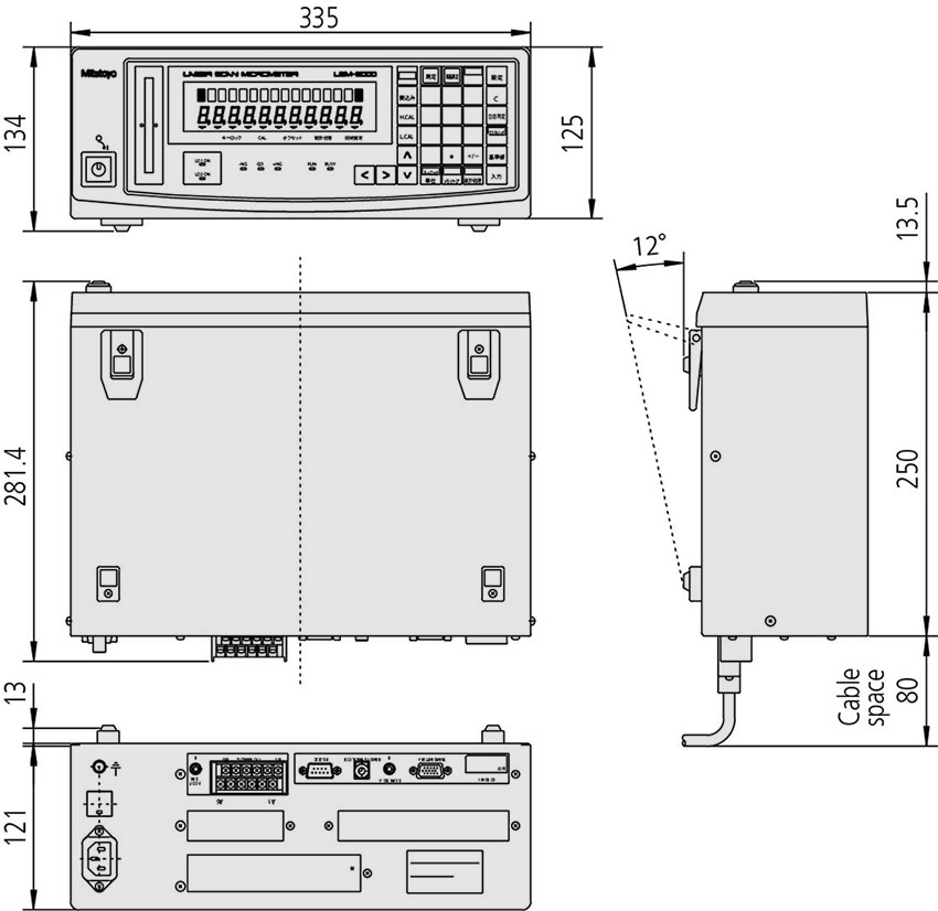

The Mitutoyo LSM-6200 display unit continuously monitors set-up values and provides readouts for two measurement values simultaneously.
The Mitutoyo LSM-6200 series display provides excellent versatility for real-time laser scan micrometer measurement readouts. Its dual-display design allows setup values to be monitored continuously. A simultaneous measurement function allows two measurement value items to be displayed on the sub-display.
  • Automatic workpiece detection starts measuring when a workpiece advances into the specified measuring area
  • Capable of statistical analysis such as average, maximum value, minimum value, range (max. – min.) and more
  • Segment measurement (7 points) or edge measurement (1 to 255 edge) can be selected
  • Abnormal value elimination function removes false readings for more accurate measurements
  • 100 tolerance values, preset values or settings can be stored for single operation recall
