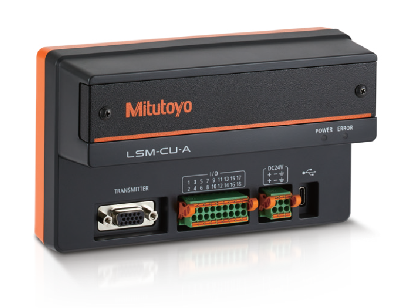

LSM-CU-A
The LSM-CU-A is a compact, modular industrial controller unit specifically designed for use with the LSM-02-A and LSM-30-A Laser Scan Micrometers. Built for seamless integration, its slim design is DIN rail compatible and operates on a reliable DC+24 V power supply. This versatile controller includes essential connectivity like USB Type-C and I/O ports, with optional industrial interfaces available. Configuration is made easy with the included software, making the LSM-CU-A an efficient hub for your precision non-contact measurement system.
The LSM-CU-A is a compact, DIN rail compatible industrial controller for LSM-series micrometers, offering modular design, USB Type-C/I/O connectivity, and configuration software.
• Compact, thin design to fit seamlessly into distribution boards or equipment.
• Entire unit, including the cable, can be stored within a 100 mm deep distribution board.
• Tool-free mounting on a DIN rail.
• Equipped with USB Type-C, I/O ports, and optional industrial interfaces.
• Standard configuration software included for user-friendly setup.
• Unit can be rotated 90 degrees for flexible layout options.
