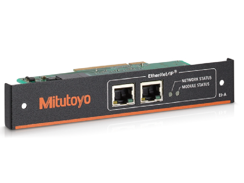

LSM-EI-A
The LSM-EI-A is an interface module specifically designed for integration with the LSM-CU-A controller. This version features an EtherNet/IP industrial interface, allowing you to seamlessly match your production line requirements. The module’s design facilitates easy insertion without the need to alter your existing controller layout. Other interface types (PROFINET, EtherCAT, and CC-Link IE TSN) are available as alternative modules to suit various automation standards.
This LSM-EI-A module provides an EtherNet/IP industrial interface for the LSM-CU-A controller, ensuring flexible communication without altering the existing layout.
  • Controller design allows for module insertion without altering the layout.
  • 2 x RJ45 100Mbps Full duplex
  • Cat. 5e or higher
Function
Specifications
Order No.
02AGG300
Model
LSM-EI-A
Communication standards
EtherNet/IP
Interface LED NETWORK STATUS Indicator: Dual Color LED1 (red/green)
MODULE STATUS Indicator: Dual Color LED1 (red/green)
RJ45 connector
2 channels
Ethernet communication Communication port
RJ45 × 2
Communication speed
100 Mbps Full duplex
Cable used
Cat.5e or more STP cable
