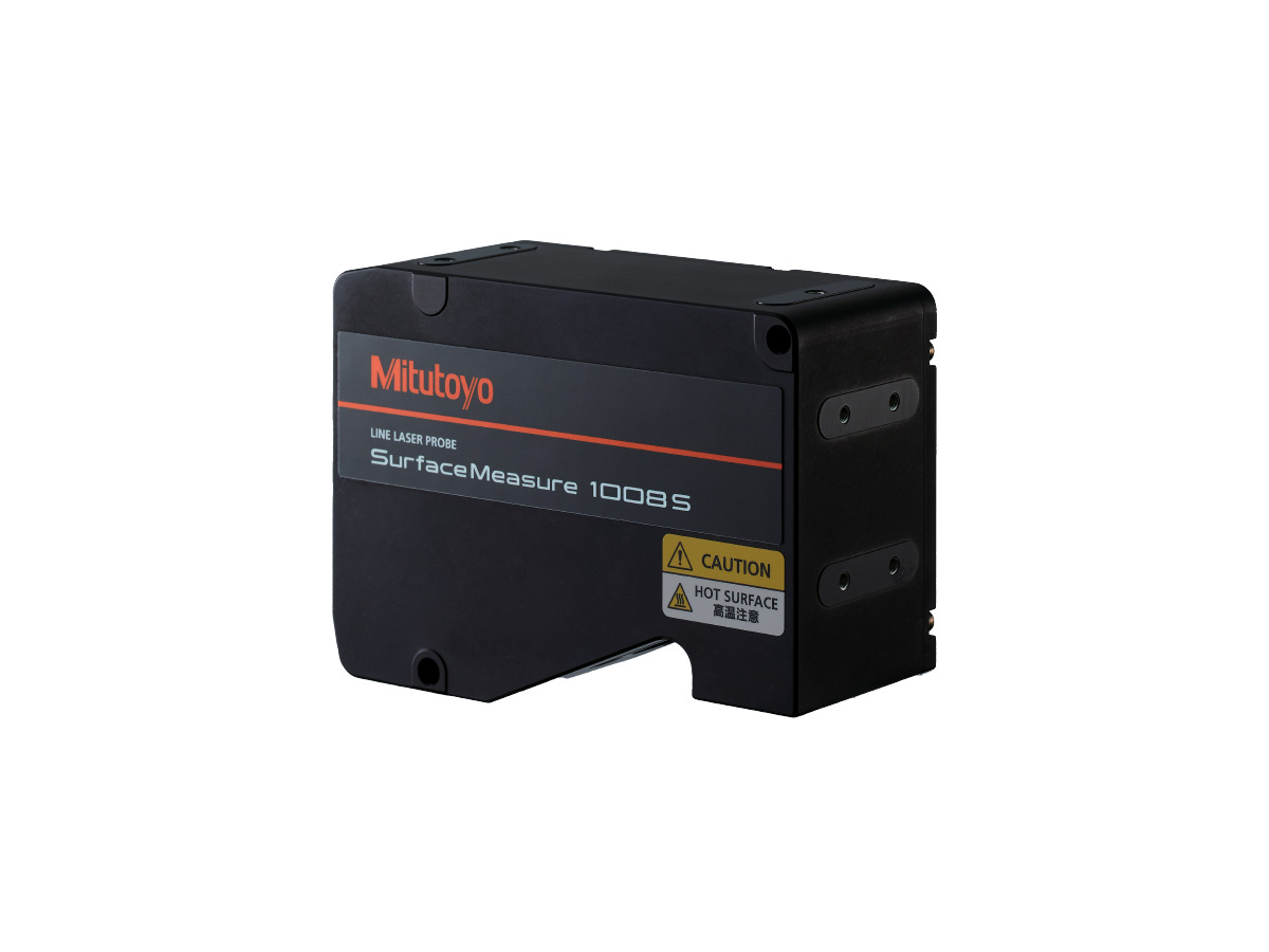

Surface Measure 1008S
The Mitutoyo SM1008S is a high-accuracy, environment-resistant sensor designed for precise and efficient automated measurements. The sensor’s advanced capabilities include high-speed profiling and 3D shape measurement, with a maximum frame rate of 10 kHz, and an automatic judgement function that eliminates the need for alignment. Its built-in, user-friendly software allows for immediate use without installation, ensuring seamless operation right out of the box.
  • High accuracy and environment-resistant sensor
  • Supporting automated measurement
  • Excellent operability simply by using a mouse
  • Simple and intuitive interface
  • Web-browser based, no need to install software
  • Various built-in measurement
  • 2D and 3D data can be obtained
