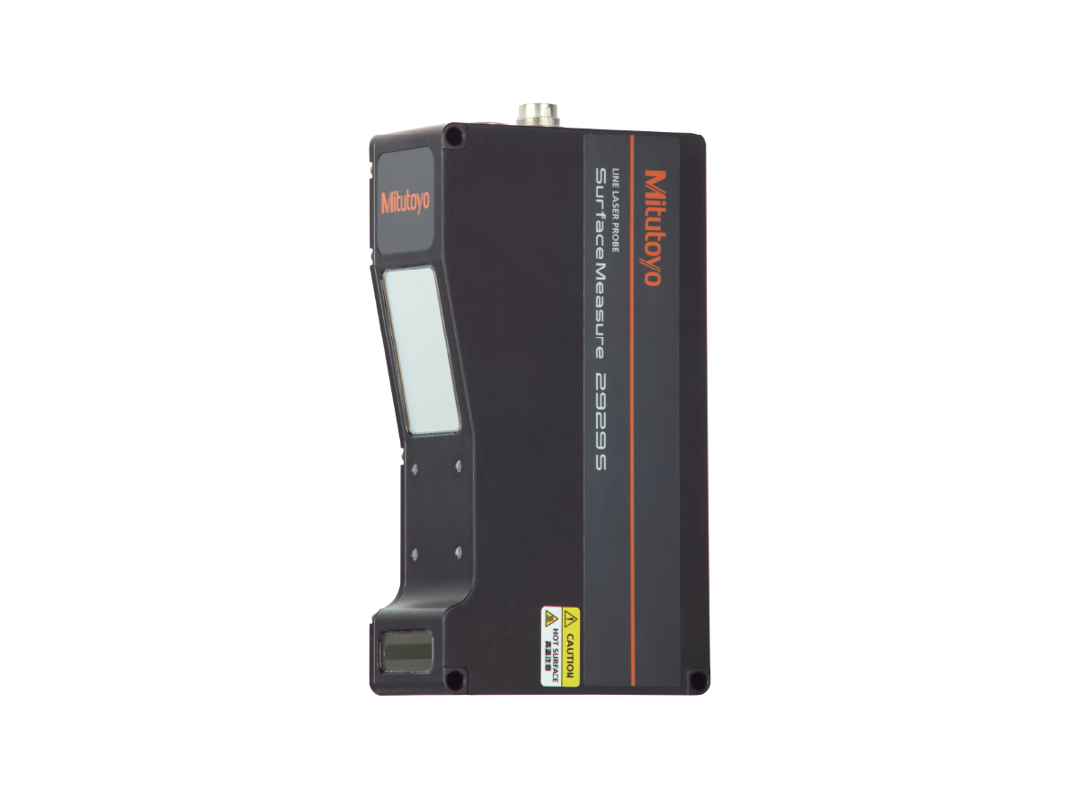

This non-contact line laser sensor for in-line measurement boasts a maximum measurement range of 292 mm in width and 290 mm in depth.
  • High accuracy and environment-resistant sensor
  • Supporting automated measurement
  • Excellent operability simply by using a mouse
  • Simple and intuitive interface
  • Web-browser based, no need to install software
  • Various built-in measurement
  • 2D and 3D data can be obtained

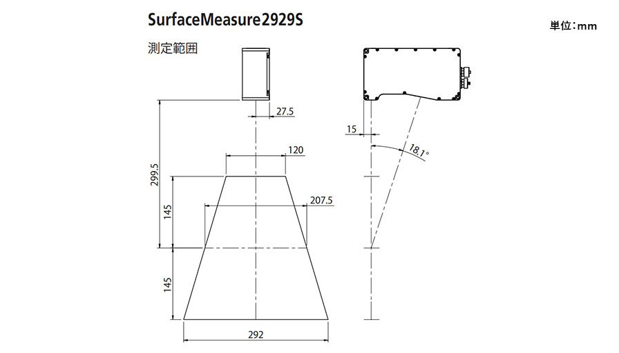

Function
Maximum measuring width:
292 mm
Measuring range:
290 mm
Working distance:
299.5 mm
Scanning error (1ơ)*¹:
65 µm
Frame rate:
Max. 10 kHz
Laser Class EN/IEC:
(EN/IEC 60825-1:2014)
Laser Class JIS:
CLASS 2 (JIS C 6802:2014)
Line Laser Medium:
Semiconductor laser
Line Laser Wavelength:
405 nm (visible)
Line Laser Max. Power:
2.2 mW
Operating Environment Temperature:
0°C to 40°C
Operating Environment Humidity:
RH 20% to 80%, non-condensing
Storage Environment Temperature:
-30°C to 70°C
Storage Environment Humidity:
RH 20% to 95%, non-condensing
IP Protection Class:
IP67*²
Power supply:
24V to 48VDC (15W)
Mass:
1480 g
*1 Accuracy inspection environment: Temperature 20°C ± 1°C, Humidity 50%RH ± 10%RH
Measurement workpieces: Specified reference ball for inspection (Φ30 mm)
Inspection method: Determined by Mitutoyo-specified inspection method.
The operating environment and the storage environment are different from the guaranteed accuracy environment.
*2 Measuring accuracy may deteriorate if any water droplet or dust particle adheres to the optical path.
