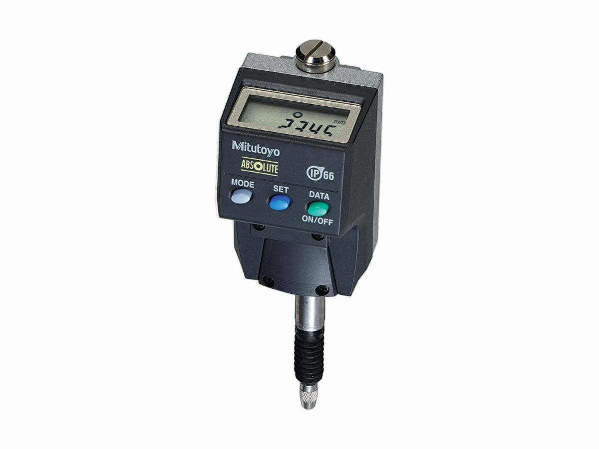

The Mitutoyo ABSOLUTE Digimatic ID-B series indicator offers a rotatable, mountable back-plunger style body and is ideal for measuring in harsh workshop conditions. Measurements are shown on a rotatable LCD display.
The Mitutoyo ABS ID-B Series digital indicator features a back-plunger style body that rotates up to 180 degrees for taking measurements from different directions. The body mounts to a leveling machine tool table or inspection jigs and its slim design allows for use in restricted spaces where graduations of standard gages are difficult to read. The ID-B indicator measures linear distances up to 5mm (metric only) or 5.6mm/.22” (Inch/Metric models), and some models a selectable resolution with accuracy of up to +/-0.003mm/.00012”.
  • Signal can be outputted to an external device; waterproof data output connector protects against dust, water and oil ingress
  • Functions include: Zero-setting, presetting, direction switching, tolerance judgment, display hold, data output, resolution switching, and inch/mm conversion (on inch/metric models only)
  • Sealed housing meets IP66 rating for improved protection against water, dust, oil and water jets
