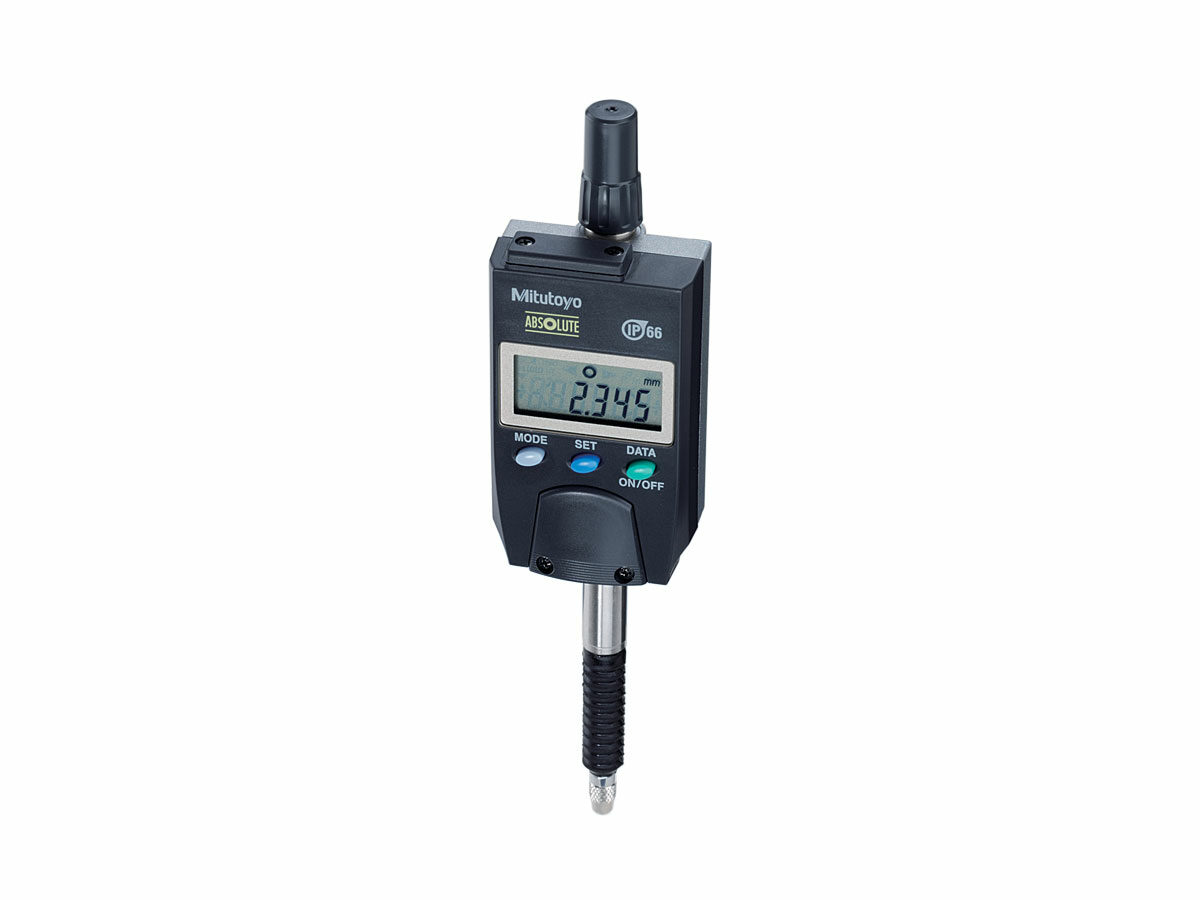

The Mitutoyo ABSOLUTE Digimatic ID-N series indicator is ideal for accurately measuring short, linear distances in tight spaces and harsh workshop conditions. Measurements are shown on a rotatable LCD display.
The Mitutoyo ABS ID-N Series digital indicator features a slim body that rotates up to 180 degrees for taking measurements from different directions. The 35mm-wide body provides measurements in tight, restricted spaces where standard gage graduations are difficult to read. The ID-N indicator measures linear distances up to 5mm (metric only) or 12.7mm/.5” (Inch/Metric model), and some models have a selectable resolution and accuracy of up to +/-0.003mm/.00012”.
  • Signal can be outputted to an external device; waterproof data output connector protects against dust, water and oil ingress
  • Functions include: Zero-setting, presetting, direction switching, tolerance judgment, display hold, data output, resolution switching, and inch/mm conversion (on inch/metric models only)
  • Sealed housing meets IP66 rating for improved protection against water, dust, oil and water jets
