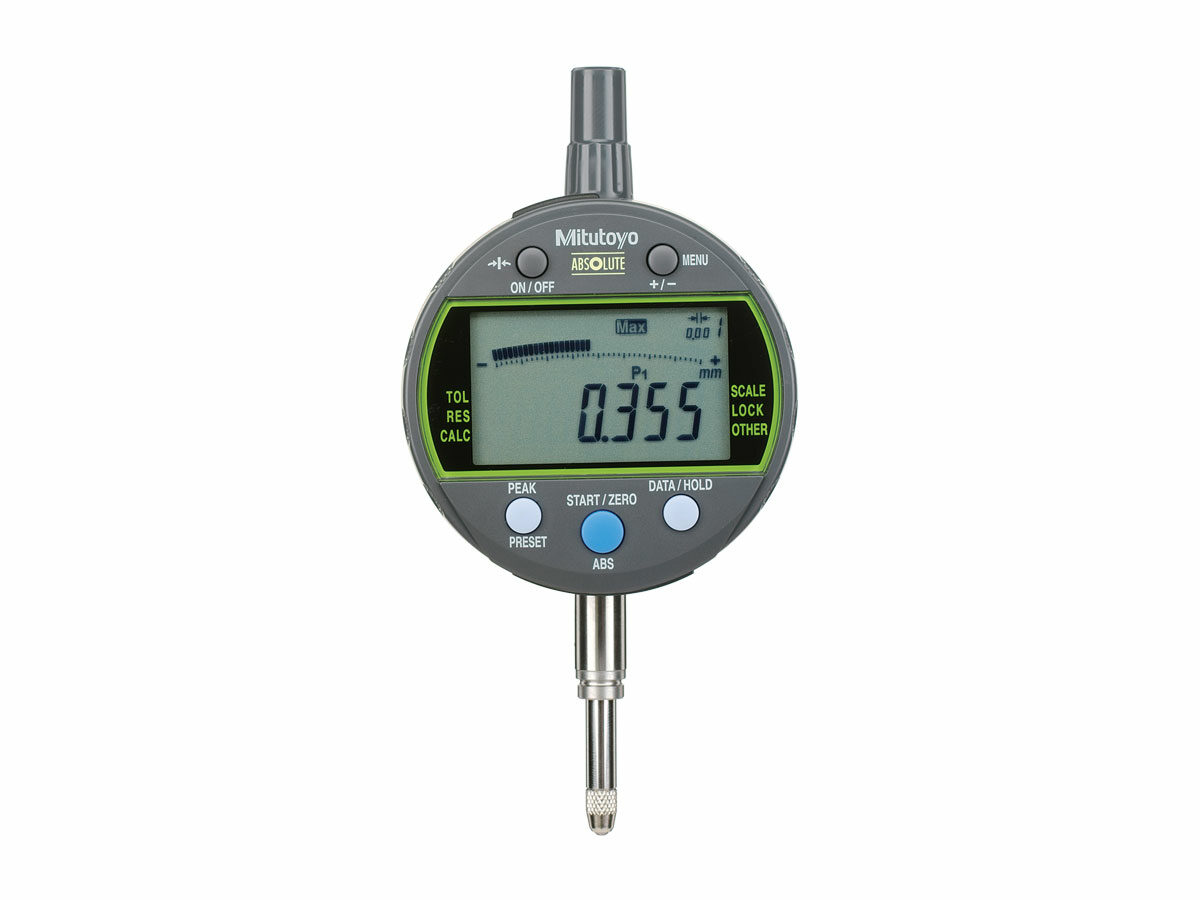

ABSOLUTE Digimatic Max/Min Indicator ID-C
The Mitutoyo ABSOLUTE Digimatic ID-C Max/Min value holding function indicators show maximum, minimum or runout values during measurement on a large, easy-to-read LCD display.
The Mitutoyo ABS digital ID-C Max/Min value holding digital indicators feature peak hold function to provide fast, highly accurate maximum measurements. By setting upper and lower tolerances for maximum, minimum and runout values, the indicator performs Go/No-Go judgements for quickly checking tolerances on multiple workpieces. A Key Lock and Parameter Lock feature prevents accidental changing of settings during operation. The ID-C indicator shows readings on a large 11mm LCD display.
  • Fast measurement frequency allows users to increase the number of readings per second, from 10 to 50, allowing for higher accuracy measurements of TIR and MAX/MIN
  • Improved parameter setting software
  • Analog bar provides easy-to-read values when scanning for Max, Min and TIR values
  • ABSOLUTE (ABS) linear scale eliminates the need for setting the origin point every time the instrument is powered on
  • SPC output function allows for fast and easy data management in real time
  • Functions include Key lock, parameter lock, PC-USB input, analog bar, fast measuring frequency, peak detection, calculation, counting direction switching, power On/Off, data output and inch/mm conversion (on inch/metric models only)
  • IP42 for protection against objects greater than 1mm and water

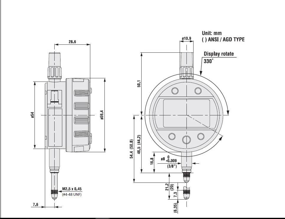

Order No.: Product Image: Units: Min Range: Max Range: Resolution: Accuracy: Stem diameter: Thread type: Back Type: Optional Accessories: ANSI/AGD type: ISO/JIS type:
543-300 Metric 0mm 12.7mm 0.001, 0.01mm ±0.003mm 8mm M2.5 X 0.45 Flat Back - - Yes
543-300B - Metric 0mm 12.7mm 0.001, 0.01mm ±0.003mm 8mm M2.5 X 0.45 Lug Back - - Yes
543-301 Metric, Inch 0" / 0mm .5" / 12.7mm .0001, .0005, .00005" / 0.001, 0.01mm ±.0001" / ±0.003mm 8mm M2.5 X 0.45 Lug Back - - Yes
543-301B - Metric, Inch 0" / 0mm .5" / 12.7mm .0001, .0005, .00005" / 0.001, 0.01mm ±.0001" / ±0.003mm 8mm M2.5 X 0.45 Flat Back - - Yes
543-302 Metric, Inch 0" / 0mm .5" / 12.7mm .0001, .0005, .00005" / 0.001, 0.01mm ±.0001" / ±0.003mm 3/8" 4-48 UNF Lug Back - Yes -
543-302B Metric, Inch 0" / 0mm .5" / 12.7mm .0001, .0005, .00005" / 0.001, 0.01mm ±.0001" / ±0.003mm 3/9" 4-48 UNF Flat Back - Yes -
