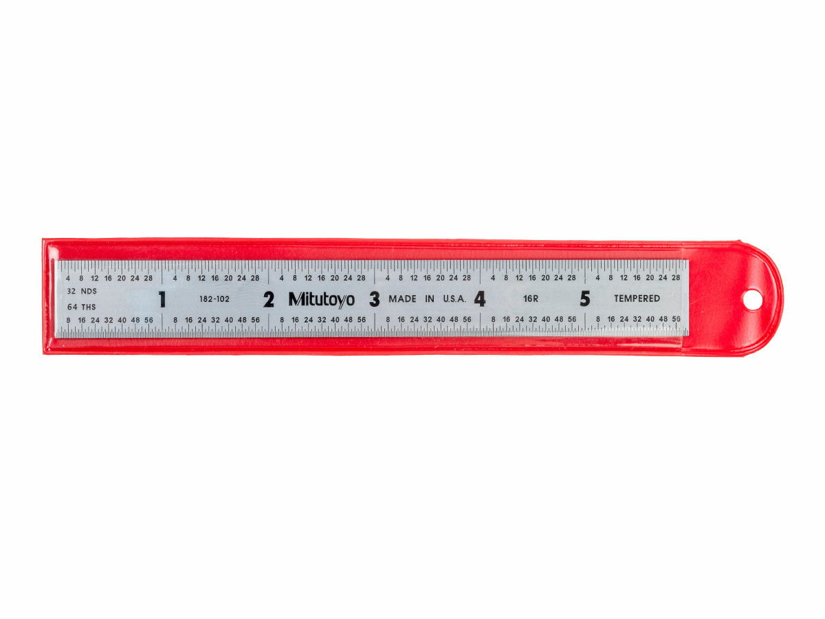

The Mitutoyo Wide Rigid Steel Rules provides highly accurate length and other linear measurements.
Series 182
The Mitutoyo Wide Rigid Steel Rules are constructed with tempered stainless steel to ensure accuracy of length measurements and to provide better durability for a longer instrument life span. The clear graduations on the satin-chrome finish makes measurement reading easier. The rigid steel rulers are designed to not flex.
- Available in many different sizes, graduations and widths
- Graduations are easy to read
- Ruler thickness is 3/64” for rigidity
- Constructed of tempered stainless steel
