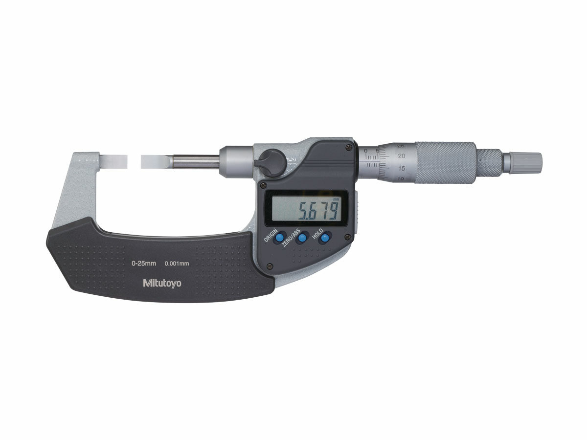

Blade Micrometer-Non-Rotating Spindle
The Digimatic non-rotating spindle type blade micrometer quickly measures grooves, keyways and hard-to-reach areas with high accuracy.
The Mitutoyo Digimatic blade micrometer utilizes a blade anvil and spindle for measuring difficult pieces such as groove diameters of shafts and keyways. The non-rotating spindle reduces torsion on softer parts being measured and prevents workpiece deformation and wear. A ratchet-stop mechanism provides uniform pressure on a workpiece for precise, repeatable measurements. Readings are displayed on an easy-to-read LCD readout.
  • Ratchet thimble allows for easy single-hand use when measuring objects
  • Elimination of overspeed errors provides for more reliable and repeatable measurements
  • Knurled friction thimbles provide quick adjustments even when wearing gloves
  • IP54 protection resists debris, dust and water
