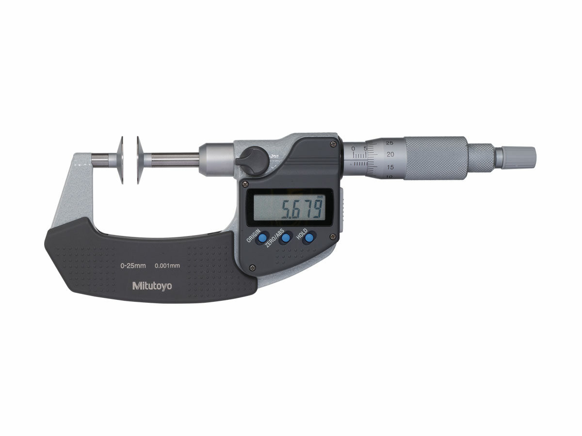

The Mitutoyo Digimatic non-rotating spindle disc micrometer is designed to measure the root tangent length of spur gears and helical gears with high accuracy.
The Mitutoyo digital disc micrometer uses flat discs and non-rotating spindle made with hardened steel in our own Japanese factory to measure lengths of spur and helical gears. The flatness and thinness of the discs allow for reliable measurements in tight spaces. The non-rotating spindle reduces torque on parts being measured and prevents workpiece deformation and wear. A ratchet-stop mechanism provides uniform pressure on a workpiece for precise, repeatable measurements. Readings are displayed on an easy-to-read LCD readout.

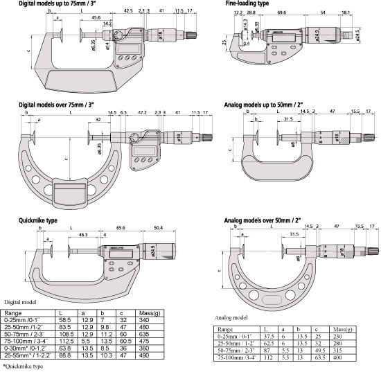

  • Diameter of measuring discs is 20mm / .787”
  • Measuring surfaces are constructed of carbide to reduce wear
  • Includes a standard bar except for 0-15mm / 0-.6”, 0-25mm / 0-1”, and 0-30mm / 0-1.2” models

Order No.: Product Image: Units: Range: Resolution: Accuracy: Disk Diameter: Mass: Graduation: Flatness: Parallelism:
369-250-32 - Metric 0-25mm 0.001mm ±4µm 20 ømm 340g 0.01mm 1µm 4µm or less
369-251-32 Metric 25-50mm 0.001mm ±4µm 20 ømm 480g 0.01mm 1µm 4µm or less
369-252-32 - Metric 50-75mm 0.001mm ±6µm 20 ømm 635g 0.01mm 1µm 6µm or less
369-253-32 - Metric 75-100mm 0.001mm ±6µm 20 ømm 475g 0.01mm 1µm 6µm or less
369-350-32 Metric, Inch 0-1" / 0-25.4mm 0.00005" / 0.001mm ±0.0002" / ±4µm 0.787 øinch / 20 ømm 340g 0.001" / 0.01mm 1µm 0.00020" or less / 4µm or less
369-351-32 Metric, Inch 1-2" / 25.4-50.8mm 0.00005" / 0.001mm ±0.0002" / ±4µm 0.787 øinch / 20 ømm 480g 0.001" / 0.01mm 1µm 0.00020" or less / 4µm or less
369-352-32 - Metric, Inch 2-3" / 50.8-76.2mm 0.00005" / 0.001mm ±0.0003" / ±6µm 0.787 øinch / 20 ømm 635g 0.001" / 0.01mm 1µm 0.00030" or less / 6µm or less
369-353-30 - Metric, Inch 3-4" / 76.2-101.6mm 0.00005" / 0.001mm ±0.0003" / ±6µm 0.787 øinch / 20 ømm 475g 0.001" / 0.01mm 1µm 0.00030" or less / 6µm or less
