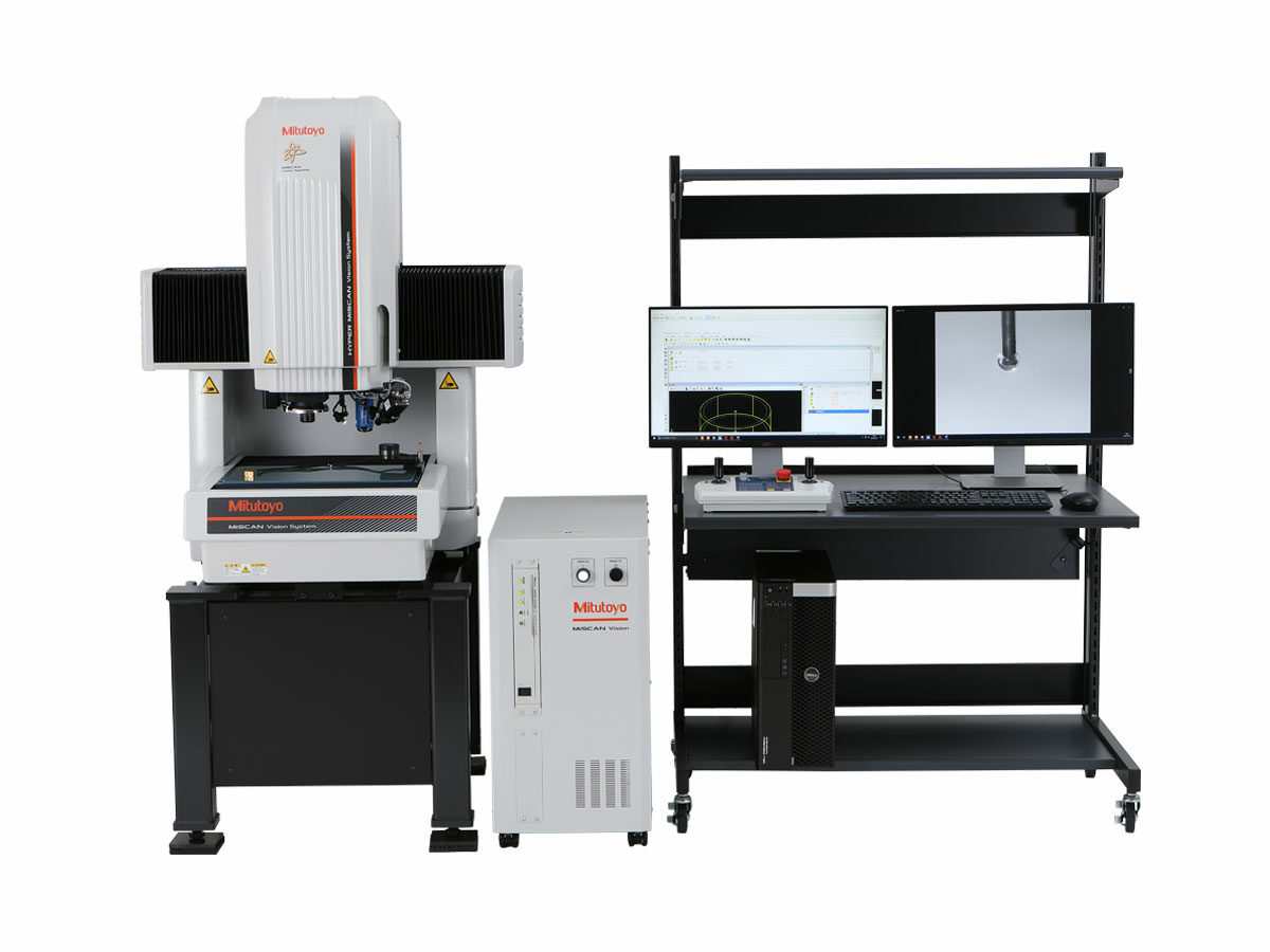

The UMAP measuring system uses an ultra-low force probe along with Mitutoyo proprietary sensing technology to attain highly accurate measurements on micron scale features.
The Mitutoyo Quick Vision Hyper UMAP features an ultrasonic micro probe that senses the amplitude variation while probing. The extremely small stylus, with high aspect ratios, makes dimensional measurements of microscopic forms possible, and can measure form deviations of features too small for traditional probe technology.
- Camera and UMAP probe provide high-accuracy contact and non-contact measurements in one machine
- Several diameters of micro-stylus are available from 15 µm to 300μm diameter
- Main frame structure has a fixed-bridge construction achieving high-accuracy measurements
- Standard temperature compensation offers higher accuracy in measurements
