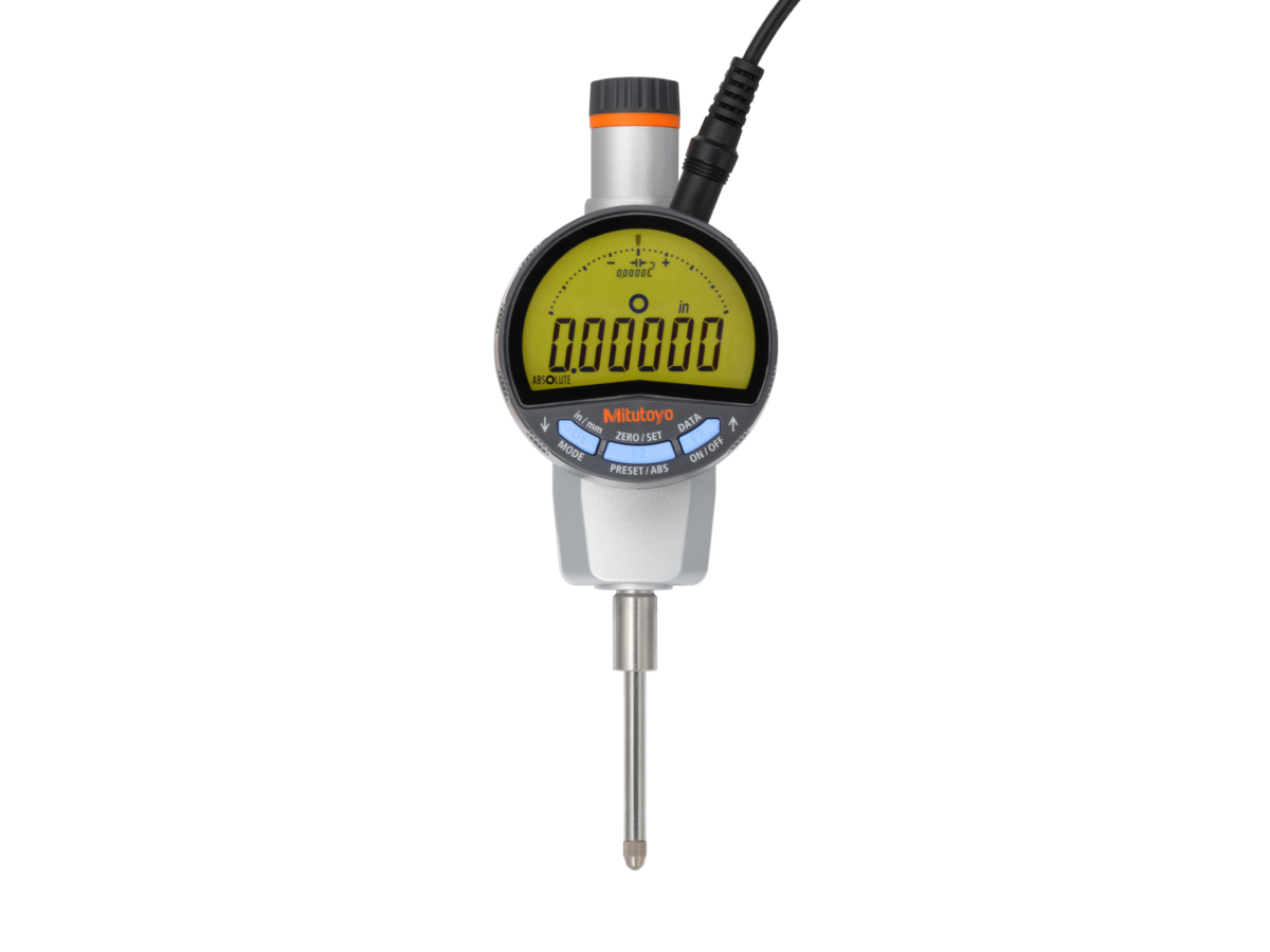

Series is a next-generation indicator with various new functions, supporting bidirectional communication. With the addition of the appropriate data cable and software, remote zero setting and gage setting can all be implemented from a connected PC, thereby improving your work efficiency.
Clear Readability and Instant Judgment
- The large 11 mm character display and expanded analog bar drastically increase readability and reduce operator eye strain by allowing measurement results to be viewed quickly from a distance.
- An integrated multi-color LCD backlight shifts colors to match tolerance judgment results (e.g., Green for OK, Red for Failure), allowing staff with no special training to instantly perform pass/fail checks.
- A flexible 330-degree rotary display mechanism ensures maximum data visibility and comfortable viewing at any angle, whether the indicator is mounted vertically or horizontally.
Smart Connectivity and Workflow Efficiency
- Proprietary DIGIMATIC S1 bidirectional serial communication streamlines data tracking and eliminates manual transcription errors by enabling seamless data collection and remote batch configuration from a computer.
- Advanced integration with USB-ITPAK V3.0 software slashes preparation time by allowing operators to perform batch zero-setting, batch presetting, and device status monitoring across multiple indicators simultaneously.
- Three large, customizable face buttons let operators map their most frequently used functions (such as calculation coefficients, resolution switching, or data hold) for quick, single-touch access.
High-Precision Metrology and Reliability
- An ultra-precise maximum resolution of 0.5 micrometers (0.0005 mm) combined with a low indication error of 0.0025 mm successfully meets the strict quality demands of high-precision inspection applications.
- An automated calibration schedule warning function safeguards your quality management protocol by blinking a notification icon as the deadline approaches and flashing the entire screen if the limit is exceeded.
- A continuous AC adapter external power supply completely eliminates battery replacement costs and associated downtime, making the indicator ideal for long-term automated testing or continuous process monitoring.
